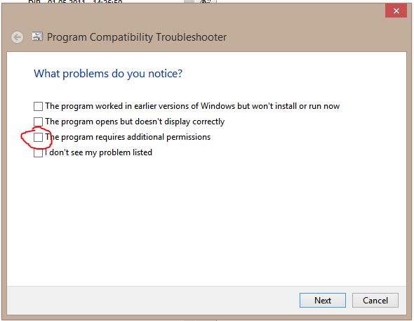

You can force run any exe file as admin with Troubleshoot compatibility wizard (right click menu on exe). There is option to get higer rights. Maybe you set it with it? Check it.
