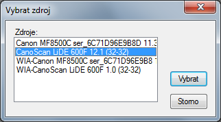

We will need feedback from other users regarding this problem. I just did test with Canon LIDE 600F scanner and Altap Salamander 3.03 x64 works fine through WIA-CanoScan scanner source. Altap Salamander 3.03 x86 works fine for both WIA-CanoScan and native CanoScan driver.
Unfortunately I'm not able to test Xerox scanner.
Does anyone else have problem with Altap Salamander 3.03 (x86/x64) and image scanning?

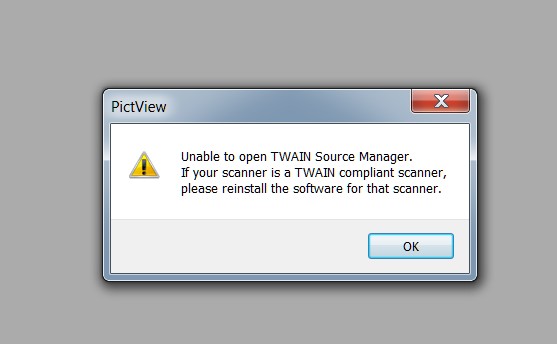

Re: PictView - scanning error
That's bad to hear - less hope for my issue to be finally resolved
But I am unsure it depends on the scanner model - as in x64 it just does not give any option, just tells it can't open TWAIN.
I have Xerox WorkCentre 3119 - but it is actually the same model as Samsung SCX-4200 (just renamed). Anybody can check it on Samsung MFPs?
And, as I have noted above, in x86 versions the bug appeared in 3.02 - so does it have any differences in handling TWAIN from 3.01?
Or maybe I need to install some more drivers? That's unprobable as that scanner works fine with other programs for me.
Well, it seems that Jan has a fix - making both WIA and not WIA working in 3.03/x86 like it used to work in 3.0 and 3.01, thanks! Strange that the fix did not make it to 3.04 x86...
And I still have that 'Unable to open TWAIN...' problem in any x64 versions of Salamander. It turns out that this issue is not related to Salamander (as other x64 programs can't scan either) nor to my scanner (as other devices, like iPhone, are not available as well). Thus, it seems to be a Windows problem.
Could anyone please check if their TWAIN devices work in x64 OS with 64-bit programs (like Salamander x64, Photohop x64 etc.)? I have Windows 7 x64 with x64 drivers for my Xerox 3119 (analogue of Samsung 4200) installed, but somehow both TWAIN and WIA work only in 32 bits scanning programs for me.
By the way, one more minor note: when PictView finishes scanning, it closes the WIA window and switches to the main Salamander window - not to the PictView window, which is rather unconvenient.
