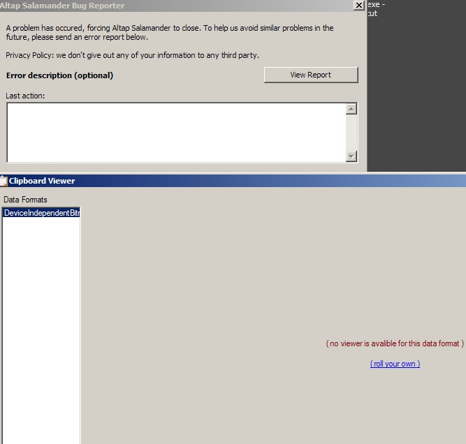

i started clipboard viewer at system startup, and just experienced one of these salamander startup crashes. the clipboard viewer, however, was reporting no data to display right after the crash (please see attached pic). the data type seems to be reading 'deviceindependentbitmap'. though that may just be the screen grab that i took _after_ the crash happened. prior to that i was working with an audio sw (that uses xml data i believe to store data in the clipboard). either way, i saw nothing in clipboard viewer.

ok, so upon another salamander crash (and a subsequent string of crashes on startup), the clipboard viewer was again showing nothing. opening wordpad, typing in a random string, going ctlr+c and restarting salamander has then indeed fixed the startup crash loop.
edit-- i seem to have narrowed it down. the crash occurs when a certain type of object had been added to the clipboard in a certain application prior to launching salamander. for this object, i indeed see nothing in clipboardviewer, or in wordpad if i try to flush it by ctrl+v. other types of objects from that same application, when added to the clipboard, do not cause salamander to crash on startup. these 'harmless' objects in clipboard do show xml data in cliboardviewer.
