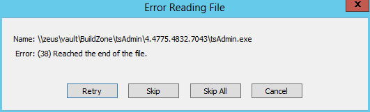

After updating to AS 3.0 beta 3, I get the following error copying files from our server. Never seen this before:

Very interesting. Please tell us what version of Windows is on your computer and what is on server and what file system is on server (use Ctrl+F1 on server path). We would like to reproduce it and fix the problem.

Even asynchronous read operation can report end-of-file synchronously, it's rare but real. I have added support for this and richb has tested on special build that it's working. Thanks for report and testing!
This fix will be available in next version.
