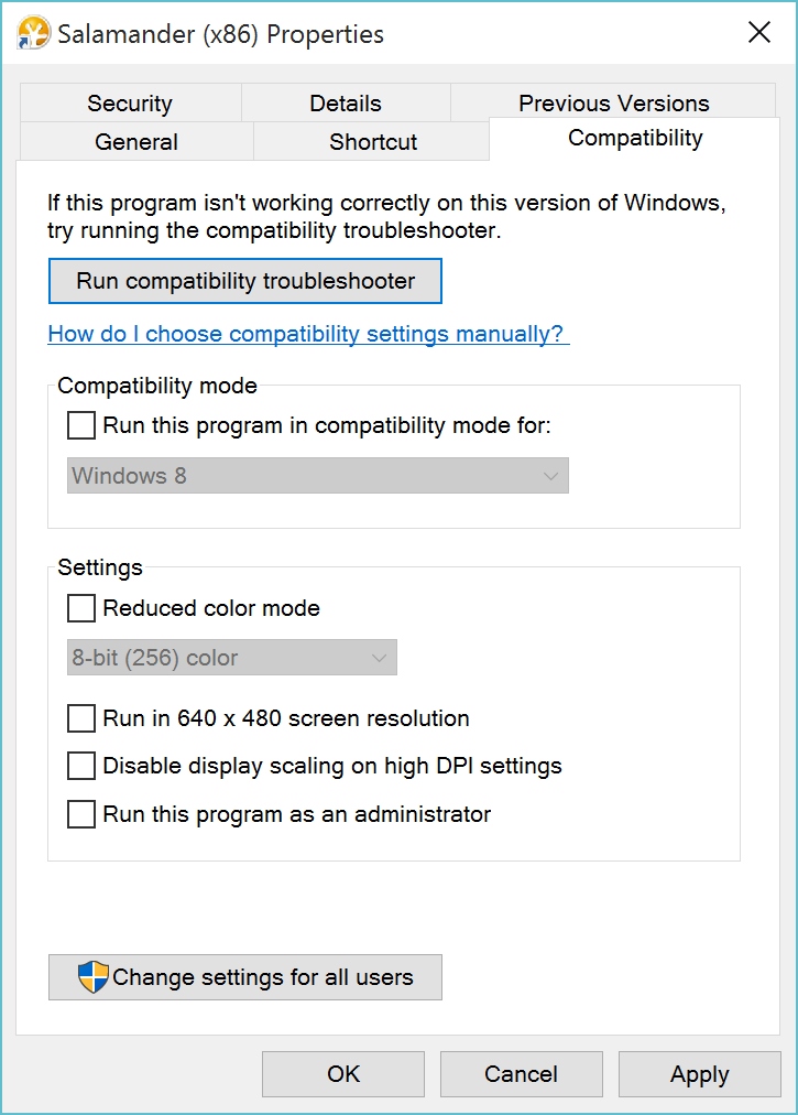

Jack, could you please open context menu for Altap Salamander 3.06 shortcut, choose Properties and check Compatibility page? Is Run this program in compatibility mode option cleared?

Yes, first thing I did was check this, then I turned it on then off, got the popup either way. I went to the executable in C:/ program files/ and it was also not checked in the properties there, for Salamand.exe.
I noticed that AS 2.56 is still in C:/Program Files (x86) and that 3.06 was installed in C:/Program files. At any rate, it's not checked (nor needed) in either. Just can't get the message to stop popping up.
