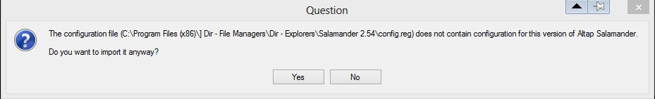

1. I recently upgraded from 2.53 to 2.54.
2. I exported the 2.53 settings into 2.54
3. I then moved the .reg file into the Salamander 2.54 programme folder (I still have 2.53 in a separate folder)
4. Everything seemed fine till I made some changes and re-saved the configuration AND exported it.
Now I keep getting this message every time I launch Salamander.
I click on "yes" and everything works fine.
Is there a way to get rid of the message?
Salamander Configutation Messgae.jpg (17.73 KiB) Viewed 8377 times
Regards - Jadag

jadag wrote:Is there a way to get rid of the message?
I guess the file really doesn't contain configuration for Salamander v2.54; I can't think of anything else. Could you put the config.reg in a ZIP file and post it here?

After reading your post, I checked and you are quite right.
The .reg file was the wrong one. I re exported the correct one into the root folder and all is okay now.
Thanks for pointing me in the right direction
