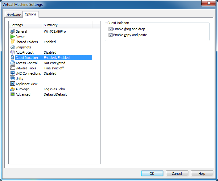

Jan Rysavy wrote:Looks like some problem with clipboard. It is interesting, could be connected with VMWare which is sharing clipboard with your host machine.
I think that would perfectly explain why the issue affects all VMs at the same time - the host OS (and its clipboard) is one of the things that they all have in common.
If you confirm that disabling clipboard integration does, in fact, prevent the freezing, could you putting different types of data into the clipboard (text, file, image...) and trying which cause freezes and which don't?
Aeries
Posts: 6
Joined: 20 Sep 2010, 18:10
Re: Salamander often freezing at start in VMWare
Post by Aeries »
I verified the VM Settings regarding the Clipboard and it's all enabled. However, I did play around a little with the clipboard and think I found something.
