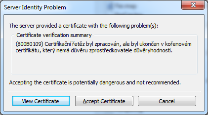

FileZilla is displaying following confirmation dialog box:

Or just skip certificate verification altogether using the -k option. I do not think the problem concerns verifying the certificate - if I understand correctly, the Salamander ftp plugin simply asks whether to accept an unkown certificate (like FileZilla does). It works correctly with my local FileZilla server with self-signed certificate.
Re: 3.0 beta 1: cannot connect using FTP with Explicit SSL
Posted: 17 Jan 2013, 08:35
Salamander FTP plugin is using Windows API to validate certificate. When certificate doesn't pass validation, confirmation is displayed.
( Address: ftp.secureftp-test.com Login: test Password: test )
You can test SSL connection to kmlinux.fjfi.cvut.cz - you should not receive any certificate confirmation.
