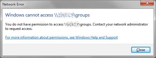

While accessing a network share over VPN to a domain \\<ip>\sharename salamander asks for credentials. So far so fine. But then a window pops up saying:
Salamander error
Salamander error
If I do the same in explorer, I get a nice error message:
Explorer error
Explorer error
The correct message should be Access denied.
OS: Win7Pro | single workstation
Server: SBS2011 | domain

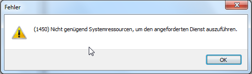

I get this when connecting to a network share:
I try to connect to an internal server using a unc path like this: \\test.server.com to view all shares on this server and get this error message:
Bild 28.png (16.05 KiB) Viewed 23223 times
Translated to English it means: Not sufficient system resources to run the requested service

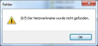

Also when I connect to a share on a MS Sharepoint server I get this:
Bild 29.png (15.03 KiB) Viewed 23223 times
Translated to English: The network share cannot be found.
  • Both shares can be accessed by Windows Explorer and Total Commander without any problems
  • Both problems are present in Salamander 2.54 and 3.0 beta 1 (x64 tested only)
Any ideas? I am willing to provide any help/logs I can to solve this.

All kinds of "solutions" to Error 1450: Insufficient system resources.
Every thread I looked at had a different "fix" :?.
(67) could be as simple as enabling "network discovery"?
But that's not going to be it in your case.
If you map the shares, are you able to connect that way?

therube wrote:All kinds of "solutions" to Error 1450: Insufficient system resources.
But not in connection to Altap Samalander. Explorer and Total Commander work fine.
therube wrote: (67) could be as simple as enabling "network discovery"?
I don't have admin access to the server. And Explorer and Total Commander work fine.
therube wrote: If you map the shares, are you able to connect that way?
I cannot map a path like "\\servername" without a share, I can only map an unc path like "\\servername\share".
What is interesting is that when I once connect to the Sharepoint share via Windows Explorer, after it it works also in Salamander! Maybe a timeout set to low?
