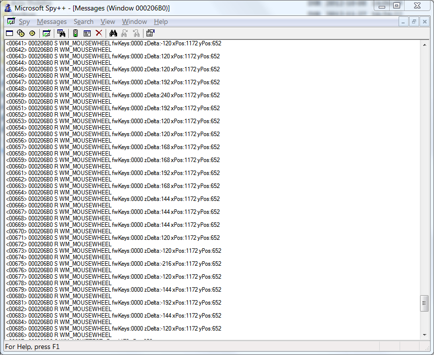

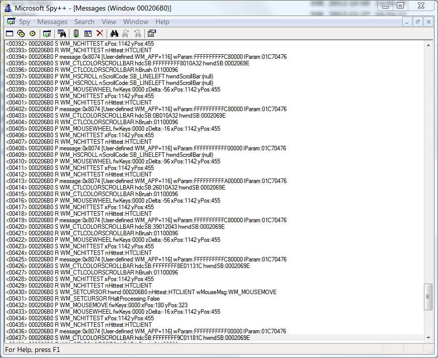

Ok, I did another test. Here are snapshots of Spy++ (64-bit) tracking one of AS panels, while trying to scroll a long list of files.
Scrolling with Wacom Bamboo 3 (works):
Scrolling with Synaptics touchpad (doesn't work):

Jan Rysavy wrote:Thank you for detailed information. We did some changes in mouse wheel handling, please try AS 3.0 beta 1 and let us know.

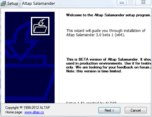

Thanks for the update. Just installed and seems to work fine so far. But the problem is still not resolved. Tested on the touchpad - doesn't work. And on Bamboo - works like before. Besides that I get such screens at installation time:
My DPI is set to 110%. My guess is, it would work properly at 100%, but probably not at 125% which is Win7 default.

Just a quick thing to mention - the screenshots I posted are from the setup program, not AS. How AS behaves might be a different thing. I don't know if it's DPI aware. It works fine for me, but I just configured the font size so it looks good.
