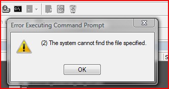

Recently I've got new PC from company, with window vista service pack 2. Once I installed Salamander, I could not launch command shell. I spoke with IT group and they tried run as administrator, but still can not launch command shell. Is there a workaround to make it work ?
Attached the error while launching command shell.

Please verify that the COMSPEC environment variable points to C:\windows\system32\cmd.exe.

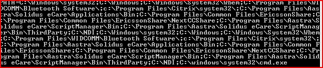

attached.
But still nothing
But still nothing
- 2011-06-09_141432.jpg (61.15 KiB) Viewed 53186 times
Re: Can not launch command shell
It seems you have attached the contents of you PATH environmental variable, but you need to check your COMSPEC environmental variable.

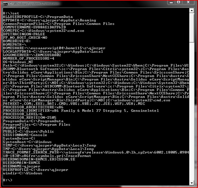

Go back to the command line and enter the SET command. You'll get a list of enviroment variables.
i.e. "C:\set<enter>" The result should have an entry like this: ComSpec=C:\Windows\system32\cmd.exe

Attach a screenshot of all these lines, please.jpermana wrote:When I tried C:\set<enter>, appear some lines, including path information like I pasted earlier.

attached.

HOMEDRIVE=H: & COMSPEC points to a location on C: drive.
Is that odd?
No its not. Your home directory has been redirected using group policy to a network drive.therube wrote:HOMEDRIVE=H: & COMSPEC points to a location on C: drive.
Is that odd?
(I dont like this techniq becaure of high risc of data corruption.
@jpermana
OK, to debug this problem, you have to download the ProcessMonitor from Sysinternals.
