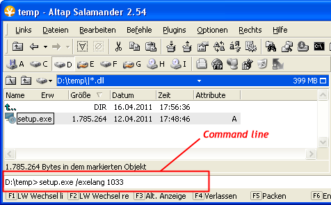

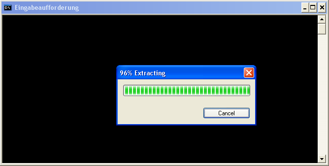

How can I execute an exe file in command line without this DOS box?

I'm using the possibility to start an exe file about the command line on the bottom of the salamander.
The DOS box belongs to salamander. You're right it's simular to you your example. Other file managers e.g. the TC (Total Commander) doesn't open the DOS box in my example. Sorry, the extracting windows belongs to the setup.exe.

The option "Close shell window after command execution (in Command line)" in the configuration menu has the same result like the "start /b" command. The problem is not to close the shell window.
I miss the option: "Hide shell window (DOS box) by execution in Command line".
I will not see this black window when I start a program from the command line like the "Run..." function from Windows XP.
