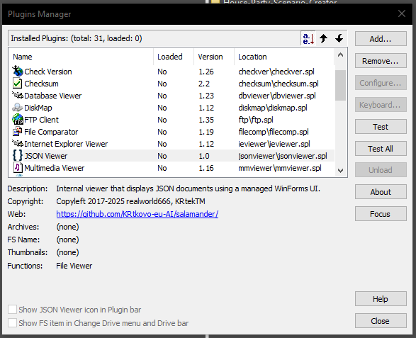

2025-09-28 08_12_36-plugins - Open Salamander 5.0 (x64) (Administrator).png (28.14 KiB) Viewed 398687 times

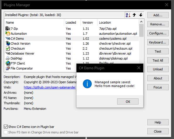

2025-09-28 08_13_04-plugins - Open Salamander 5.0 (x64) (Administrator).png (30.99 KiB) Viewed 398687 times

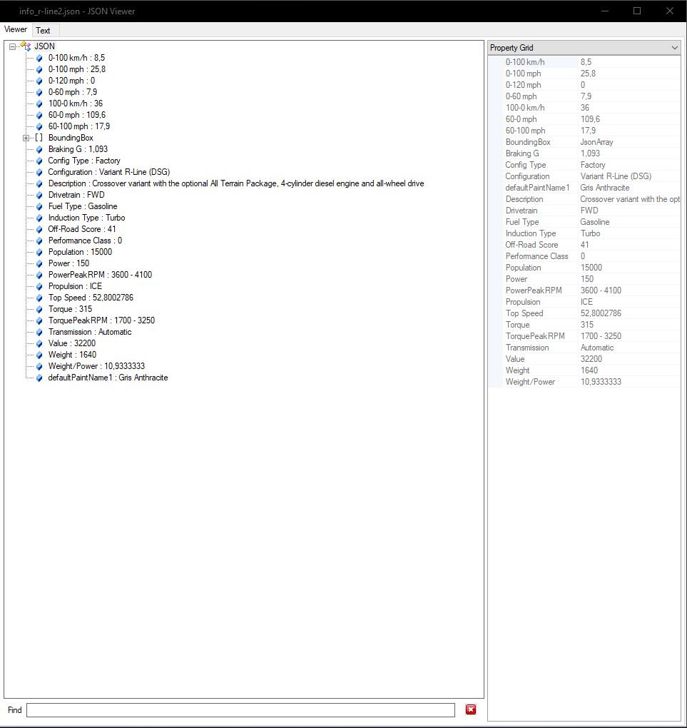

Example of the usage - Json Viewer plugin: https://github.com/KRtkovo-eu-AI/salama ... nViewerNET (which is refactored this application: https://github.com/KRtkovo-eu/JsonViewe ... Salamander )

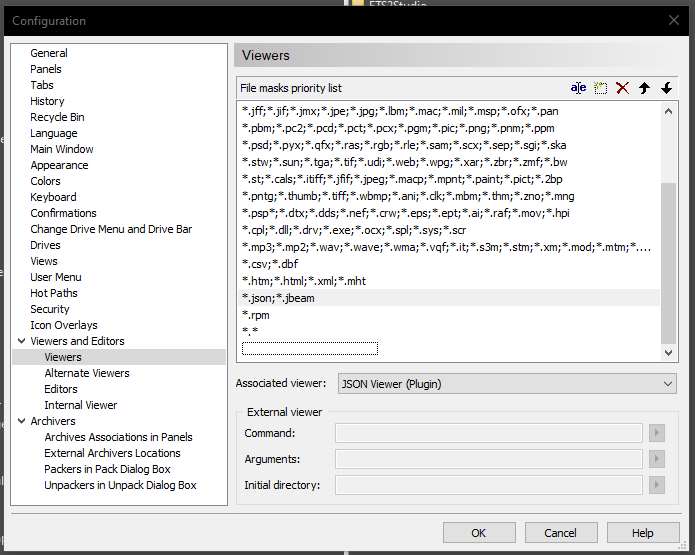

2025-09-28 15_37_12-temp - Open Salamander 5.0 (x64) (Administrator).png (29.1 KiB) Viewed 398687 times

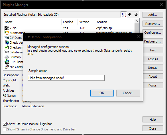

2025-09-28 15_37_27-.png (54.08 KiB) Viewed 398687 times
