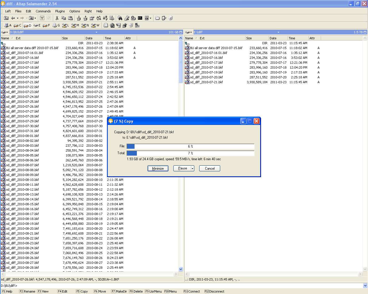

kneilson wrote:Now, all file copy operations using Salamander change the modified time/date stamp to that of the copy operation.
Can you please provide us a screenshot of Salamander having the source folder in one panel and the target folder in the other panel?

I'm glad you asked for a screenshot, because while getting it I think I've solved the problem (or as it turns out, the non-problem. The files I was copying when I noted the problem were large .bkf files that would take some time for the file copy operation to complete (120+gb). To get the screenshot, I did a file copy with some smaller files, and quickly saw what was really happening. It appears that when the copy begins for each individual file the date/time stamp in the copy to frame is listed as the current date/time. That is what I was seeing, and thought that it was this date/time stamp that would stick with the copied file. Not wanting to have this, I cancelled the operation before it finished. If I'd been patient, however, I would have seen that once each file copy is completed, the time/date stamp applied to the copy is indeed the original time/date. As you can see from the screenshot, all the already copied files have the correct original time/date stamp, and the currently being copied file has the current time in the copy to frame, rather than the original date/time. As soon as the copy of this file is completed, the date/time stamp changes to the original and the operation moves along to the next file. So my perception of a problem was only that - a perception.

Re: preserve date and time for file copy
kneilson wrote:once each file copy is completed, the time/date stamp applied to the copy is indeed the original time/date
Yes, during the copying, Salamander is actually modifying the file, so it has to wait with the timestamp change until it's finished.
