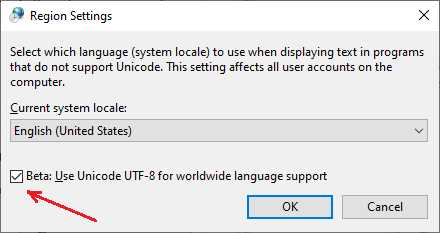

In April 2018 with insider build 17035 (nominal build 17134) for Windows 10, a "Beta: Use Unicode UTF-8 for worldwide language support" checkbox appeared for setting the locale code page to UTF-8. This allows for calling "narrow" functions, including fopen and SetWindowTextA, with UTF-8 strings. In May 2019 Microsoft added the ability for a program to set the code page to UTF-8 itself, and started recommending that all software do this and use UTF-8 exclusively.

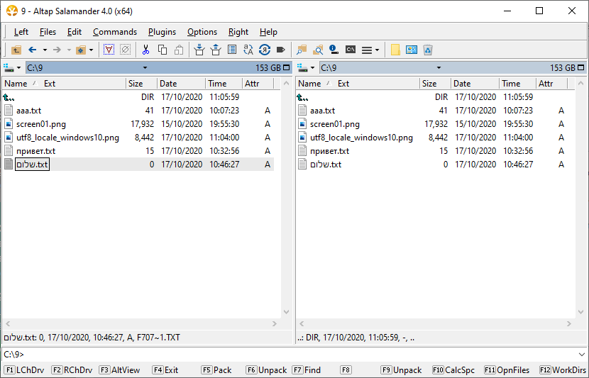

With the UTF-8 locale enabled Altap Salamander 4.0 can work with multiple languages in file names. For example English, Russian and Hebrew simultaneously.

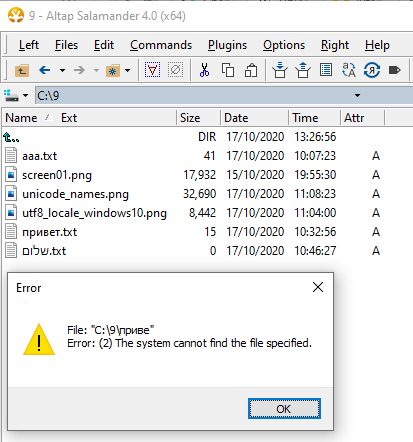

This is still not perfect. For example if I do Ctrl+C and then Ctrl+V on some of non-English named file its name is not properly taken. Seems like a wrong string length calculation (most likely truncates bytes according to amount of UTF-8 chars where the first six chars encoded by 12 bytes)

I did some quick testing using the internal Altap copy/move functions (F5/F6) and everything just worked. Czech, Russian, Hebrew, Polish. Copying, moving and launching in UTF-8 aware external app. Very, very nice.

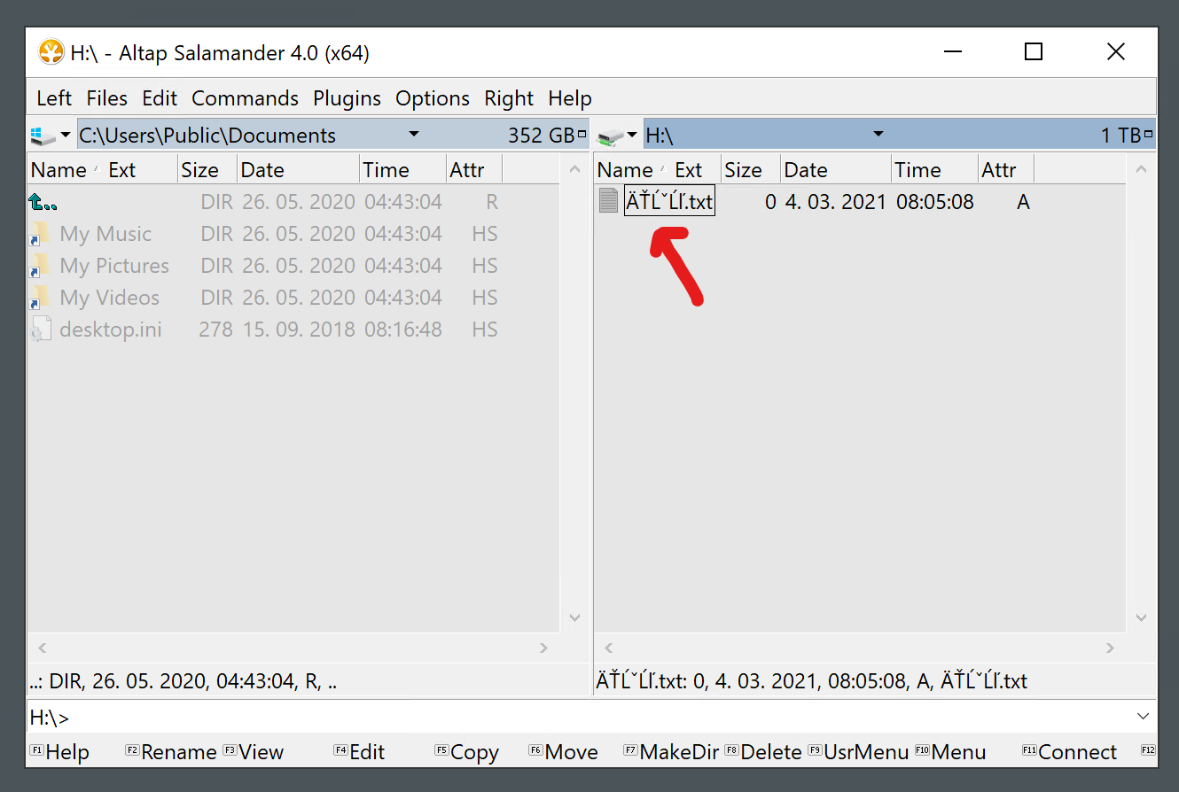

Nevertheless, Salamander works remarkably well on UTF-8 Windows 10. The only issue I noticed is it does not work properly on Windows Server 2019:
Screenshot 2021-03-04 080843.png (98.53 KiB) Viewed 90712 times
The actual filename is "čšž.txt".
