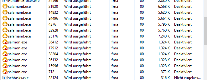

I have the same problem on two computers. Both are running the latest Windows 10 updates. Both are Windows 10 Pro 64bit.
I disabled the shell extensions and tried "WhatIsHang". But this doesn't indicate anything to me. The Task Manager also shows that Altap Salamander is still running (see screenshot).

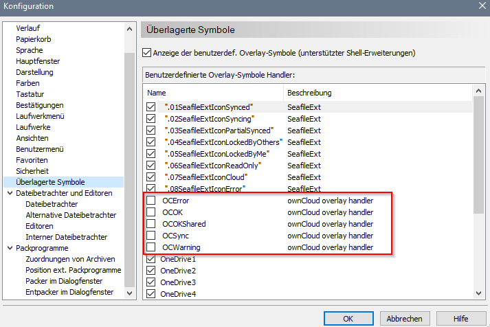

I've found a solution to my problem. I'm using Nextcloud on my computers for file synchronization and have activated the overlay icons.
If I deactivate them in the Altap Salamander settings, the program quits normally.
