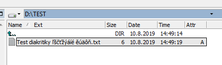

Toto je screenshot z AS4.0 32 bit na Windows 7
2019-08-10-Altap Salamander-001.png (4.81 KiB) Viewed 64155 times
Chod podla navodu na:
https://www.isunshare.com/windows-10/ch ... ws-10.html
a prever ci tam mas nastavenu Slovencinu.
