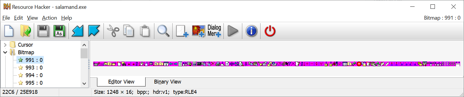

Right now... using Resource Hacker edit salamand.exe
Export toolbar image, convert it using Paint.NET to grayscale and save back into Salamander. Highlighted icons will stay grayscale. Another option would be convert SVG images from Altap Salamander\toolbars into grayscale (using Inkscape).
