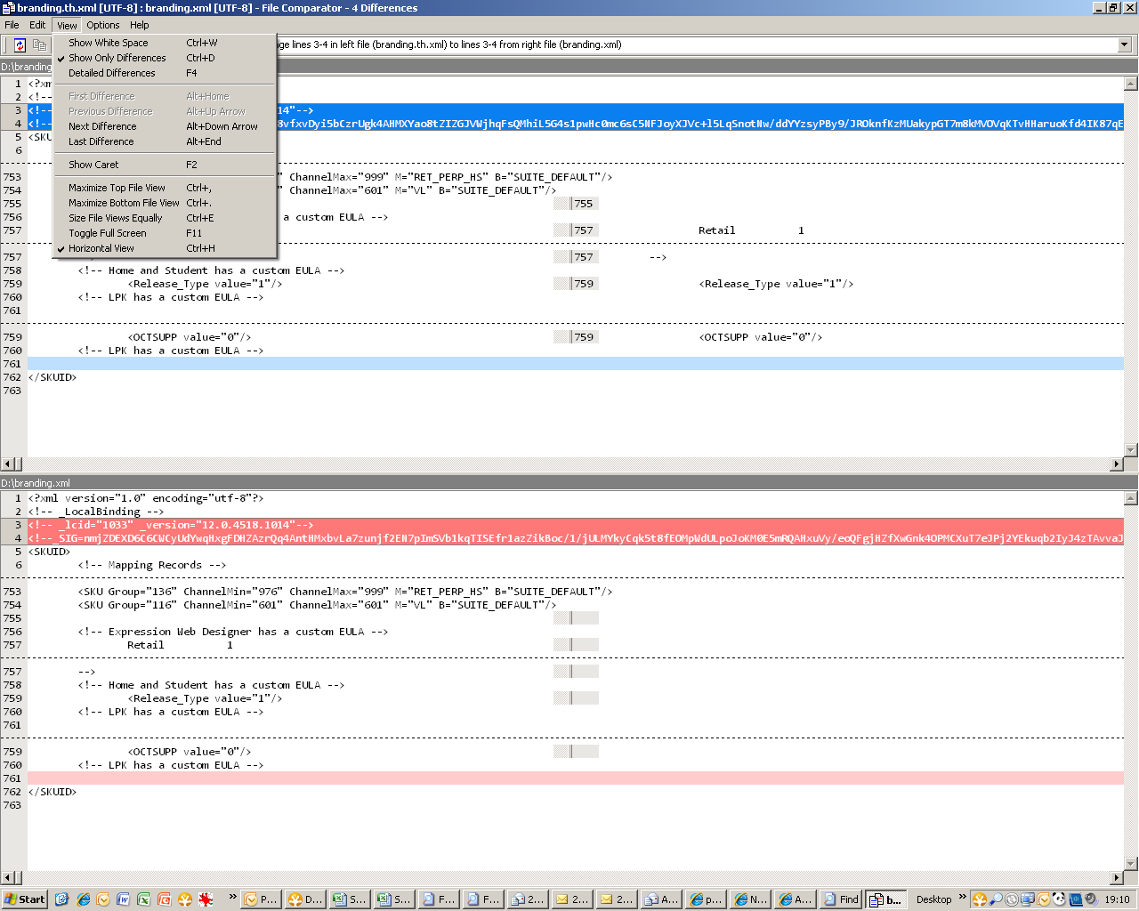

Comparing your 2 files with "Show only Differences" shows also lines with no differences.
Switching to "Horizontal View" does not refresh the whole display (leftovers of linenumbers).

- wrong display of file comparator
- linenumber-leftovers.png (87.27 KiB) Viewed 21732 times
