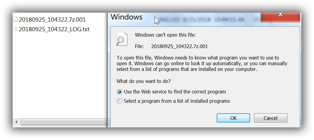

I would like to find out how to open a file with an extension of *.7z.001
I have C:\Programs\7-Zip\7z.exe
I have Salamander 3.08
When I select the file with extension 7z.001 I get this window:

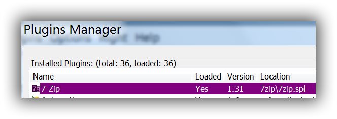

I have run Options, Archivers Autoconfiguration
It did not find C:\Programs\7-Zip\7z.exe
How can I configure Salamander to open these files?
