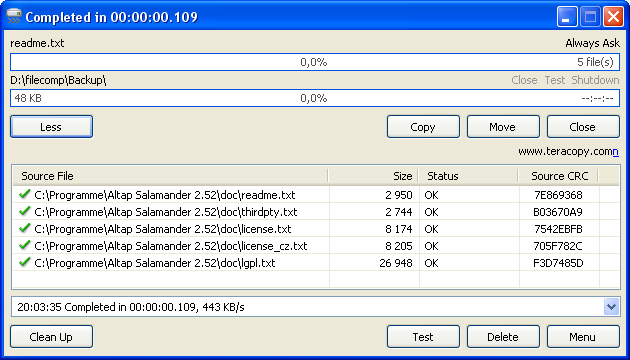

The TeraCopy argument [*] reads the content of an added variable.
In this example from the text file filelist.txt (selected in panel)
C:\Programme\Altap Salamander 2.52\doc\readme.txt
C:\Programme\Altap Salamander 2.52\doc\thirdpty.txt
C:\Programme\Altap Salamander 2.52\doc\license.txt
C:\Programme\Altap Salamander 2.52\doc\license_cz.txt
C:\Programme\Altap Salamander 2.52\doc\lgpl.txt
copy *$(ListOfSelectedFullNames) "$(FullPathInactive)"

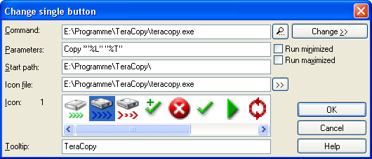

Configuration of TeraCopy for Copy:
TeraCopy Command Line (v2.0+ only)
TeraCopy.exe Operation [*]Source Target [/SkipAll] [/OverwriteOlder] [/RenameAll] [/OverwriteAll] [/NoClose] [/Close]
    * Operation: Copy|Move|Delete|Test|Check
    * Source: File or folder
    * *Source: Path to filelist
    * Target: Destination folder
The Use of TeraCopy for Altap Salamander is rather small, because the variable [*]Source doesn't works with salamander. But the use with Total Commander is optimal, because the selected source -> *Source: Path to filelist

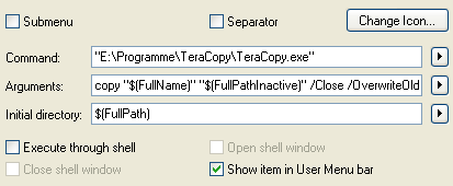

OK...here's what I did.
I downloaded the portable Teracopy, extracted it and put Teracopy.exe and portable in a Teracopy folder within the plugin folder. I added Teracopy to the UserMenu with these options:
Command: C:\Program Files\Altap Salamander 2.52\plugins\TeraCopy\TeraCopy.exe
Arguments: copy "$(Fullname)" "$(FullPathInactive)" /Close /OverwriteOlder
Initial Directory: $(FullPath)
Show Item in UserMenu Bar checked
I then select 4 folder with files and chose to copy. Yes thomas, multiple windows do open, but they are waiting for the previous to finish before the next one starts....I think that is fine, unless I'm missing something.
