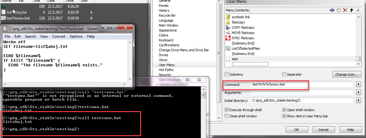

I don't have access to the Salamander's code so I can only guess here. What Salamander apparently does is use CALL inside the command prompt to call any batch file - and it consumes the '%' the same way as CMD does so you need to double the double => alias quadruple it!
For more see the picture:
Running a batch file that contains a percentage sign
P.S. I have made a obvious mistake in the batch file (SET for the filename contains only one % to show what happens. The reason why you have to use two %% is that one serves as a holder for the second one). The mistake can be fixed, as you already mentioned, doubling the %% inside the batch file.
