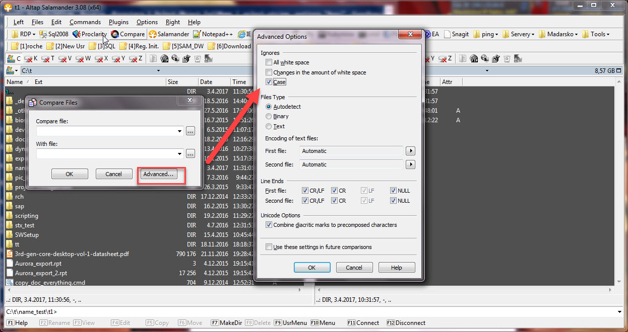

Re: Compare is not detecting upper and lower case.
This is not a windows issue.
If you want to differentiate between cases you have to click on advanced options and click on checkbox 'Case'. Then you will get correct result.

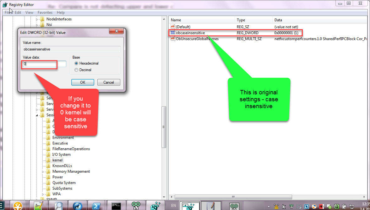

First lets talk about kernel. The default setting is case insensitivity. Is there a way to switch it on? (Warning: do not try this on production system it may damaged it!). Actually there is!
If you change the following settings the kernel will be, after reboot, case sensitive:
I don't have yet a windows 7 virtual machine to try it out, it would be interesting to see how Salamander behaves under such conditions. I'm pretty sure that win32-api applications like windows explorer will not like it.

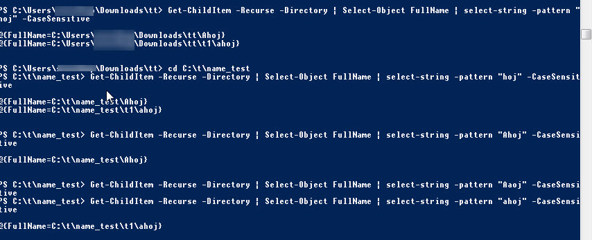

So as last resort I told my self to go to powershell, which worked excellently:
Get-ChildItem -Recurse | Select-Object FullName | select-string -pattern "[h,j]" -CaseSensitive
In pattern you can use regexp or simple string like "hello".
If you want to get only directories you can do:
Get-ChildItem -Recurse -Directory| Select-Object FullName | select-string -pattern "[h,j]" -CaseSensitive
and you will get:
