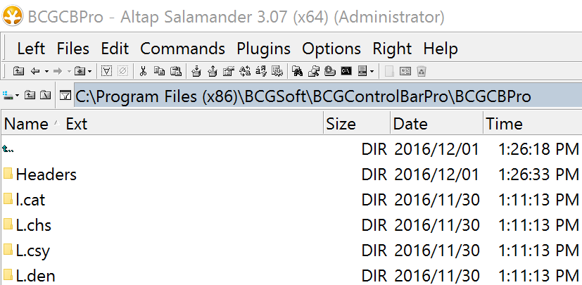

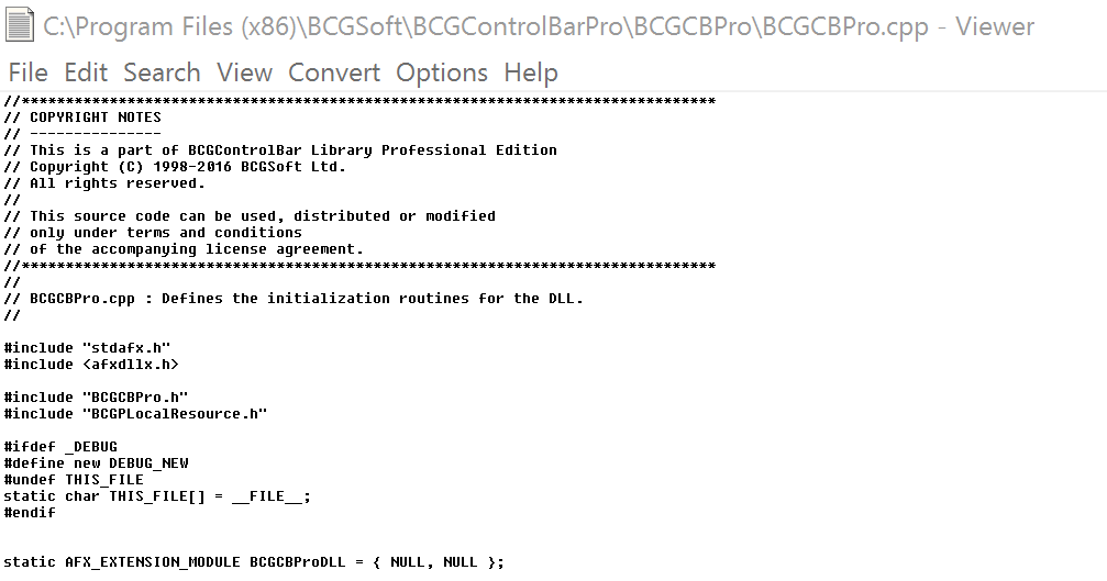

I am testing our own application on a Samsung UltraHD monitor and notice that elements of Salamander do not scale well.
The monitor is set to a resolution of 3840 x 2160 (recommended) and Windows display scaling is set to 200% (so I can actually read things).
I have attached images of the icons and the internal viewer which is where I have noticed problems so far. The internal viewer was far worse than shown as the display was set to 4pt FixedSys and, after I changed it to see any difference and wanted to set it back to grab the screenshot, the only options were 5 and 7 pt. The image is for 5 pt FixedSys.
(The inline images are enlarged so aren't a reasonable facsimile of the actual size).

There is no support for HighDPI monitors yet. Its a work in progress.

Yes, we are working on HiDPI support for Altap Salamander.

Hi, I would like to re-open this thread rather than opening a brand new one. Just bought a laptop with UHD screen, using "225%" scaling option in Windows 10, but the toolbar icons in Salamander (using 32-bit version) are still ridiculously small.
Is there a way already to adjust the size of the icons?
Thank you for letting me know.

nieboras.jan wrote: 14 Oct 2017, 17:23 Is there a way already to adjust the size of the icons?
No.
I have implemented 4k-monitor support for our applications, too, not just for Windows, but for OS X and Linux, too. It was no rocket science.
