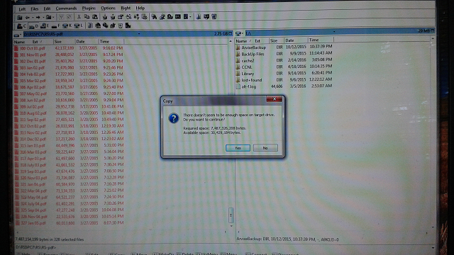

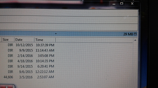

Salamander is showing 29MB of space remaining on all of my server drives while there is TB's available on each drive.
Example,, one drive properties show 1.54TB..?. while when I try to use the drive it says I have 29MB
The result is that I can no longer move files to any drive because Salamander is reporting not enough capacity (only 29MB) ??????

The server is a Dlink DNS 323 upgraded to Alt-F software.. Only on the server drives report incorrect information, Operating system is Windows 7 Ultimate. I correctly access the drives through Windows 7 as network attached drives..... The drives are attached as network drives on Salamander. I can "read" any amount of data through Salamander regardless of what drive size is indicated. I can NOT write through Salamander unless the size of the file is less than 29MB...
The server drives are ext4 formatted.

Thank you for posted screenshots. Btw, it is possible to take screenshot using Altap Salamander:
1. open window you want to capture
2. press PrtScn on your keyboard (for whole screen) or Alt+PrtScn (for active window) to capture screenshot to Windows clipboard
3. start Salamander and choose Plugins > PictView > View Bitmap from Clipboard (Ctrl+Shift+B)
4. screenshot will be displayed in PictView window, save it to PNG
Another option is to use Windows Paint for steps 3. and 4. - so you don't need Salamander / PictView plugin, see http://www.sevenforums.com/tutorials/97 ... paint.html
Back to free space problem. Could you please post more screenshots?
1. Altap Salamander Drive information window for DNS-323 drive (to open it press Ctrl+F1 in Salamander).
2. Windows Explorer window with Computer item selected - there is list of all mapped drives with disk size displayed.
3. Windows Properties dialog box for DNS-323 network drive - first General page with disk size displayed. (open it by right-clicking disk in Windows Explorer and choosing Properties command)
Thank you.

By the way, did you notice there is a "Yes" button on the dialog as a response to the question "Do you want to continue?"
Salamander does not use the initially calculated free space during copying. If the space indeed is running out, the remote system will report a write failure. If, regardless, the space is sufficient, either because the initial report was wrong, or because you created some more space while the copy process is under way, e.g. by deleting some files, salamander will successfully copy the whole lot.

PROBLEM SOLVED !!!!.... MY error.... I forgot you can not create a share to \mnt and have it report correct disk info !! ---You can read everything below the \mnt , but disk info is for that point only.
......As soon and I created my share to the individual disk \mnt\sda everything is good and all disk info is correct...
