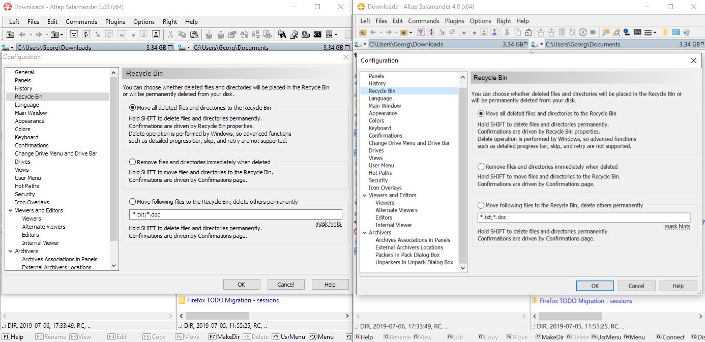

Dear all, after reading the good news, I just installed Salamander 4.0 on my Win10 PC and was curious for the new High DPI support. And found it's looking blurry while old 3.08 is crisp & clear :-(
2019-07-06 comparision Salamander 3.08 and 4.0.png (230.98 KiB) Viewed 157004 times
Only after editing the properties of the .lnk shortcut file, more precisely setting (literally translated from German) compatibility > changing high DPI settings > overwrite high DPI scaling to "System" I got a crisp display. So the same manual configuration step is required as in v3.08, while I expected v4.0 does automatically look good on Win10 & HighDPI. I'm a little sad that High DPI support seems to have been improved only in respect of new icons in SVG - or did I overlook something?
Thank you for hints, Georg

Can anyone else reproduce this problem? On our systems AS 4.0 works as expected - all text are crisp and clear (150%, 175%, and 200% scale in Display settings). We didn't change anything in Salamander shortcut properties.

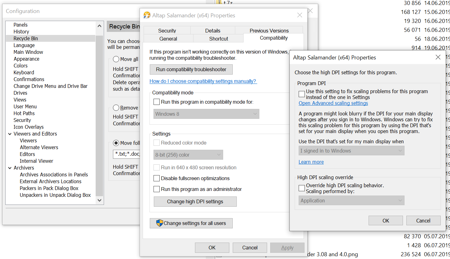

Georgd wrote: 06 Jul 2019, 18:29 Dear all, after reading the good news, I just installed Salamander 4.0 on my Win10 PC and was curious for the new High DPI support. And found it's looking blurry while old 3.08 is crisp & clear :-(
How many monitors do you have? Do you have Salamander running on the main monitor? What DPI settings do you have for the different monitors?
Because Salamander doesn't support real-time DPI changes (perMonitor and perMonitor2 HighDPI support), it loads one DPI setting at its startup and stays with it... If it loads DPI setting for the wrong monitor (this is decided by Windows and NOT by Salamander) it becomes blurry, because Windows will do bitmap scalling to the DPI setting of the current monitor.
Georgd wrote: 06 Jul 2019, 18:29 Only after editing the properties of the .lnk shortcut file, more precisely setting (literally translated from German) compatibility > changing high DPI settings > overwrite high DPI scaling to "System" I got a crisp display. So the same manual configuration step is required as in v3.08, while I expected v4.0 does automatically look good on Win10 & HighDPI. I'm a little sad that High DPI support seems to have been improved only in respect of new icons in SVG - or did I overlook something?
Here is my compatibility settings for Altap Salamander 4.0 which works correctly on my multimonitor system with different DPI settings on different monitors:
(By the way, the Windows Explorer file properties dialog and this compatibility dialog doesn't support perMonitor either on Win 10 1809 - on the second monitor with different DPI it is blurry)

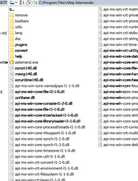

On my shortcut properties, I set exactly as previous message : Program DPI is checked and Override DPI is checked, and on ComboBox a System(Enhanced) is choose.
When I move a file with my mouse over a filename, a font become ugly
I tried many Font or size... Always same problem. To fix, I only have to reduce the window and maximize it so that the font become pretty.
In other words just refresh the window (Redraw) or press CTRL-F9 on my keyboard.
Here an exemple :
Does exist a solution for refler a font on font's filename ?
