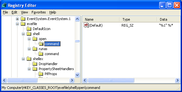

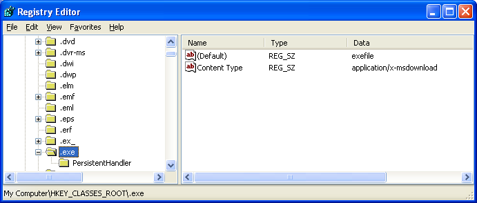

Please try to open context menu on some .exe file (right mouse click on it) in Salamander's panel. Do you see there default item (in bold font) Open? Or is there any default item at all? When you hit Enter key, Salamander finds default item in context menu and executes it.
See attached screenshots with .exe and exefile keys in registry. Open is the default item in my context menu on .exe files in XP.
- exe.png (17.9 KiB) Viewed 18031 times
- exefile-open.png (16.81 KiB) Viewed 18031 times
