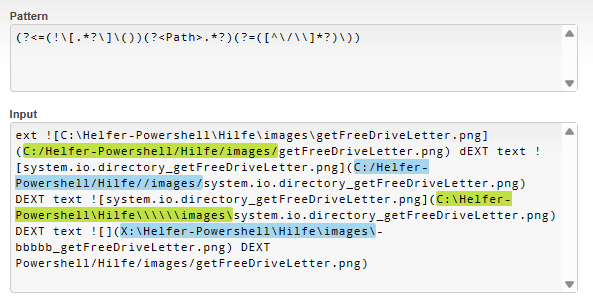

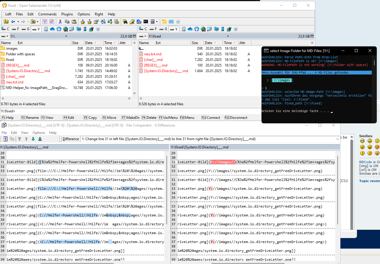

I couldn't get the relative path to work either. I've created something that allows me to repair the local image links again and again. They have to be present in the MarkDown files as an absolute local path.
It took a moment for me to get the regex for search and replace to work, but it works great: Demo > regexstorm.net

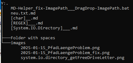

The local image path must not contain any spaces!
I created a test folder on drive Y using:
I also added my batch file to the structure, in the same location as the MarkDown files
Drag and drop one or more directories onto the batch file. A menu appears, which then allows you to use the new image directory for the image link. A directory called 'fixed' is automatically created and, if it already exists, generated with a consecutive number. The new Markdown files are stored there.
MD-Helper_fix-ImagePath___DragDrop-ImagePath.cmd

i have the batch-file modified, old:
                    $tmp = $tmp -replace '(?<=!\[.*?\]\()(?<Path>.*?)(?=[^\/\\]*?\))', $imagePath
new:
                    # ---- $tmp = $tmp -replace '(?<=!\[.*?\]\()(?<Path>.*?)(?=[^\/\\]*?\))', $imagePath
                    $patt = '(?<=!?\[.*?\]\()(?<Path>[a-z]:.*?)(?=[^\/\\]*?\))'
                    $tmp = $tmp -replace $patt , $imagePath

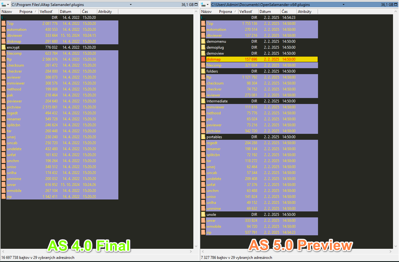

powerlicht wrote: 20 Jan 2025, 18:27 I couldn't get the relative path to work either.
I see you use a AS v5.0.
Where it is from? Some news inside, against v4.0?

AD7 wrote: 02 Feb 2025, 00:24 I see you use a AS v5.0.
Link was posted just yesterday. I wish it was more prominent, too.
I don't know what exactly has been added, but WebP preview works fantastic!
Re: Broken images in Markdown viewer
pjj wrote: 02 Feb 2025, 08:18
Thanks, I thought there was another one somewhere. :D
Quick compare of Plugins folder AS 4 vs AS 5:
powerlicht
Posts: 5
Joined: 20 Jan 2025, 17:30
