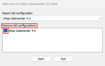

I'll note that on one computer where I put this in, during the install, I selected it to, I think it was, import my settings from my existing Salamander 4, & I think what happened, along with importing, it also zap'd my existing settings.
Not certain, but I believe that is what happened.
Just noting...
(I had a .reg export of my Salamander 4 settings, so all I had to do was to re-import that...)

It's possible that you've selected the checkbox in "Remove old configurations" section as shown on the image below.

(Yes, I may have mistakenly done that?)
