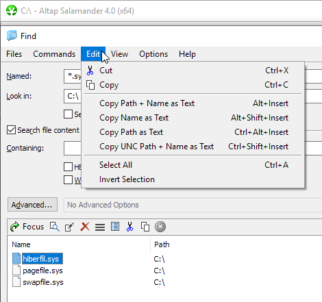

Hello there,
I use keyboard shortcut for copying file-path all the time. But this feature does not work in Find-files window CtrlF. I have to go to file Spacebar and then I can copy what I need to. It would be great to be able to do it right from the search dialog.
Thank you.

Hi skidus,
you should have created a new thread, rather than hijacking this one ...
This thread is about Salamander's lack of an option to export a list of found files, and offers various solutions.
Back to your matter. What exactly does not work where exactly?
For me, the usual shortcuts to copy various parts of the file in focus to the clipboard work ok, and also, the entries are there in the Edit menu, as always.
This may not work, if you are in a custom find dialog of a plugin file system (e.g. the registry).
