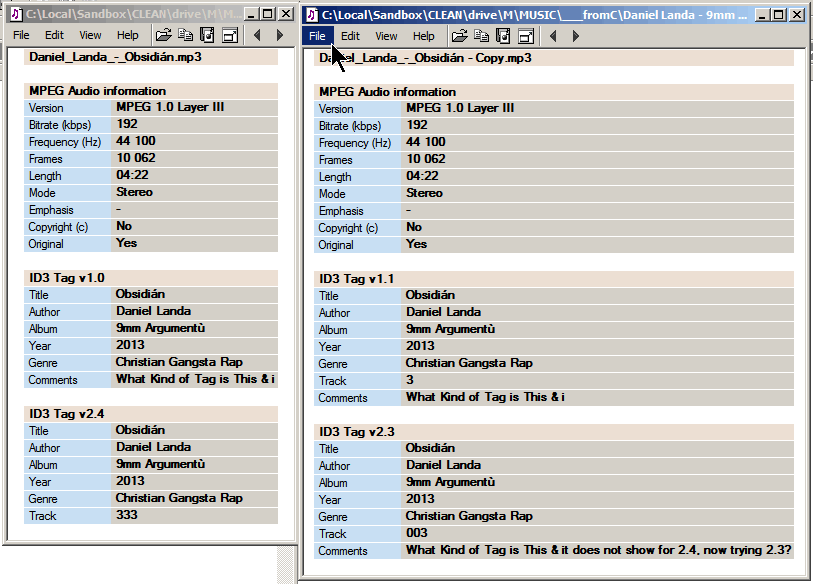

Looks like it may depend?
Just playing around.
Originally file had 2.3.
Then used ID3 Tag Editor (untested) to change it to 2.4.
Then Mp3tag to make more changes in 2.4, then changed it back to 2.3, then back to 2.4 again.
Looks like not as many fields show for 2.4 as for 2.3.
Christian Ghansta Rap

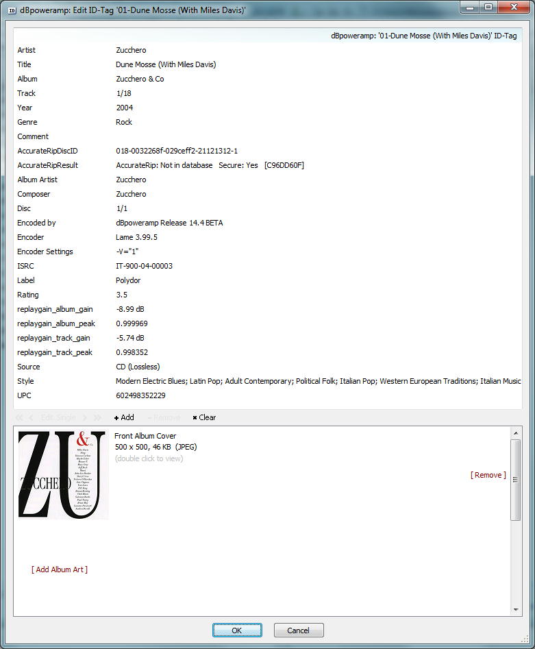

Look here with a file that has v2.4 tags (only): And here what really is in the tags:

I did some testing with text encoding in Unicode_UTF8 instead of Unicode_16 (as I did before). These are the 2 option I can select in dBPoweramp.
It still does not list all the fields with multiple entries correctly (shows only one in v2.4, and all in v1.1 !) but it now shows at least most of the fields.
