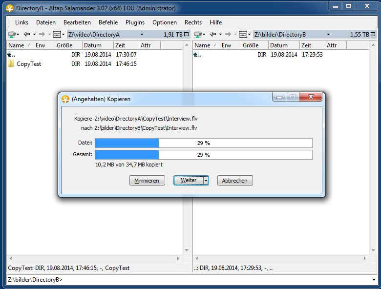

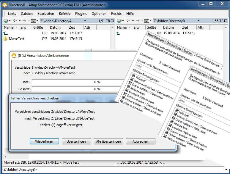

- Moving the directory fails...
- move.jpg (60.29 KiB) Viewed 45659 times
- Copying the directory is OK...
- copy.jpg (44.11 KiB) Viewed 45659 times

Thank you tukanos for your reply, but there ist nothing useful in the log even with level 3 or 4.
The curious point is, if I want to *move* the directory "Test" from one disc to another disc it fails.
If I *copy* the directory, everything goes OK.
If I first create a directory "Test" on the target disc (goes OK!) an then *move* the directory "Test" from source disc there, it goes OK too!
In latter case I get a warning message in samba log:
but this is not offending a good finish. Salamander (Samba) joins the two directories.
In failing cases of moving the directories I get no warning messages at all.

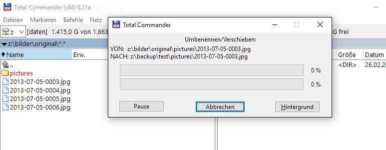

5) One further test shows: it must be a bug in AS, the unloved (for me) TotalCommander has no problems with moving a directory from one NTFS-3g box to another... I wouldn't have guessed.
greetz robw

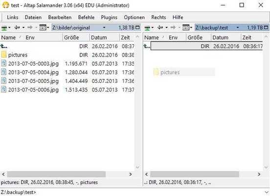

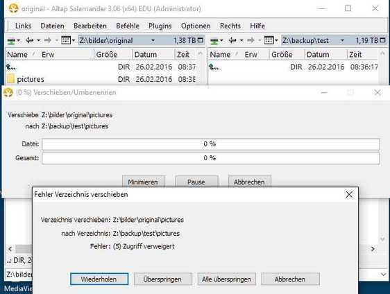

Once again -
In the meantime I use Salamander 3.06 (Windows 10 Pro)
I've ever the following problem:
I want to move a directory from one Linux-disc (Samba or not) to another - does not work in any case.
I have all rights on the shares; I can copy or delete a directory, I can create a new directory and so on...
When I want to move a whole directory from one to another share (means from one to another disc) it fails. Creating the directory on the target disc and then copying the files is OK. Moving the whole directory with windows-explorer is also OK! It's equal, if I use Salamander(x86) or Salamander(64bit).
It's not only a bit - but very, very! - annoying to make the tour: Create directory -> Copy the files -> delete the source files. I'm sure, it's not a problem of user privileges, since in Explorer it works. The only workaraound is Total Commander! But I don't love it. TC a lot better than AS.
One Year no solution. This cannot be true!
robw

As I've mentioned before it's the same behaviour today. Running Salamander 3.06 in Windows 10 as Administrator.
I have two USB-Discs with NTFS mounted in Debian Jessie. One with my picture-files, the other one as backup.
Access from Windows via Samba 4.1.17.
Copying between the two discs works very fine, equal with files and also folders.
But moving only works for files, not for folders.
Since the discs are formatted with NTFS this cannot be an issue with linux privileges - all are granted: 777!
It complains about "No Access granted" (German: "Zugriff verweigert").
In Total Commander it works. Look:
It's funny, because if the directories to move are on the same disc, it works also in salamander. But moving dirs which are on two different discs do only in Total Commander, not in Salamander.
