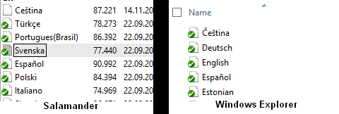

Some files don't show the Icon overlay, though others in the same directory do
TSVN Overlay Icons AS vs. Explorer
Note the file Čeština. (It's the same folder, just a different sorting)
Windows 8 x86 | AS 3.0 beta 3 (x86) | TortoiseSVN 1.7.11, Build 23600 - 32 Bit
Is this an issue with unicode? Can it be fixed even without full unicode support for AS?
By the way: What exactly is an unicode filename? As far as I know NTFS stores all filenames in unicode. Is it any filename that cannot be translated to the system's ANSI codepage?

Exactly, all NTFS file names are stored with Unicode encoding. Unfortunately Salamander is not Unicode application and there are problem with Unicode->Ansi conversion.
Regarding the problem: current TSVN version is 1.8.4. Is there any reason why should I test 1.7.11 version instead?

Jan Rysavy wrote:Regarding the problem: current TSVN version is 1.8.4. Is there any reason why should I test 1.7.11 version instead?
No, no reason. I just happened to have that version of TSVN installed when I stumbled accross this (I started to get incresingly exposed to unicode file names). I don't suppose the TSVN Version makes any difference, but if it does, and you tell me the problem is gone with a more recent version, I will be happy to update to the most recent released version. Just let me know.
Re: Missing Tortoise SVN Icon Overlay
They are still improving shell extension, it does have sense to upgrade.

I now updated both, TortoiseSVN to 1.8.4.24972 and Altap Salamander to 3.0 beta 4 (x86)
So the question remains: does Salamander pass on to shell extensions a filename that had been converted to Ansi before and can this be (easily) changed?
Yes, Salamander is using ansi file names. Unfortunately I don't think it could be easily changed (even just for shell extensions).
