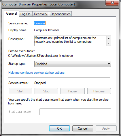

Hi, just found one thing.
When service is disabled, there is no active "Start" button in Service manager's dialog window. But in your plugit button is enabled. But it doesn't work. It throws error, because service is disabled and must be switched to Manual mode first. Right-click menu is ok.
Service manager
Service manager
Plugin
Plugin

Thank you. Will fix that in the next version.
