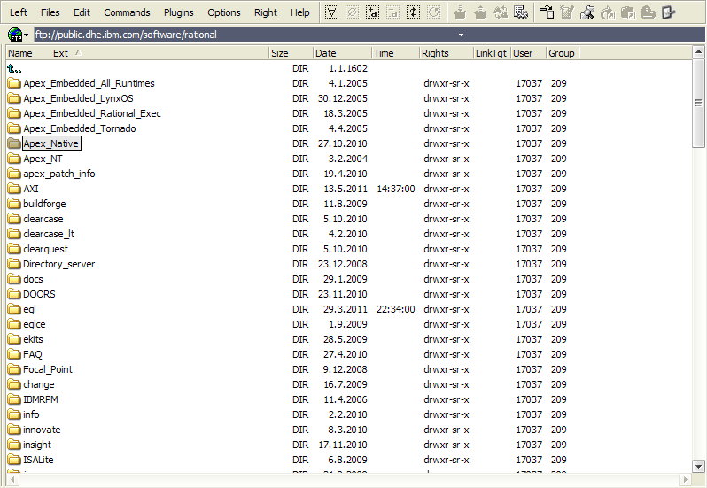

I am trying to download some updates from ftp://public.dhe.ibm.com/software/rational/clearcase, but the FTP client can't parse the listing of the rational folder.
I tried various UNIX and IBM types, but no luck :-(
Perhaps the problem is in line "drwxr-s--x1214 102004493 533 102400 Aug 30 05:42 private"?

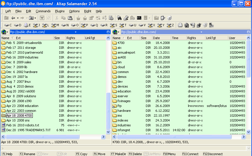

But seriously - my Salamander (2.54 EN, Win XP 32-bit SP 3 EN) has no problem with listing the Rational folder. The only problem is the Private folder, but that would be because it's private, right?
Re: FTP plugin can't parse IBM site
Slanec wrote:But seriously - my Salamander (2.54 EN, Win XP 32-bit SP 3 EN) has no problem with listing the Rational folder. The only problem is the Private folder, but that would be because it's private, right?
I wonder how you did it. AS 2.54 EN, FTP 1.32. With autodetected server type, I am even getting inconsistent results on root folder.

Jan Patera wrote:I wonder how you did it.

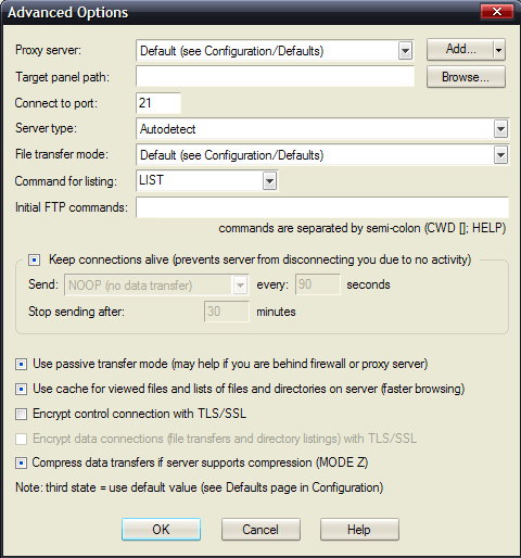

Ctrl+Shift+F (as expected), copypaste the address into Quick Connect with default setting (see picture attached), hit Enter. No hidden magic, I believe.
I tried to play with the server for a while, but I haven't encountered any problem so far.

Hmm, I should have posted the problematic URL and not the URL I wanted to get in: I was complaining about the rational folder, but the URL ends with clearcase. So, can you list ftp://public.dhe.ibm.com/software/rational ?

Can FTP plugin configuration play any role? I believe it can - mine is default (I think...). What else could be causing any trouble?
