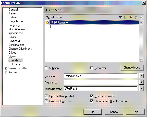

Assuming you want to process the files present in the folder displayed in the active panel, the easyest way to create a button that does what you want is to create the .cmd file and simply drag it and drop it on the user menu bar.
Salamander defaults to run the program in the folder mentioned above.
You should use a .cmd file, not a .bat file.
You should quote your %-signs by enering two %% for each one your program needs to see. Otherwise the command processor tries to fill in some environment variables and your jhead.exe probably will not do what you expected.
Then create the batch file, save it somewhere (like 'E:\jpgren.cmd'), create a new user menu item, name it, type the program path 'E:\jpgren.cmd' into the Command field, leave the Arguments field empty, leave Initial directory to be $(FullPath), leave all options set, and enjoy.

the user menu item
the user menu item
