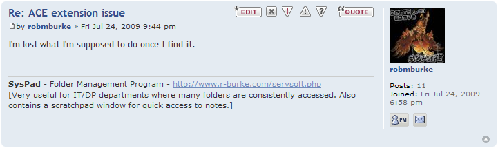

I'm lost what I'm supposed to do once I find it.

OT: robmburke, please update your signature according to our forum rules. Thank you.
