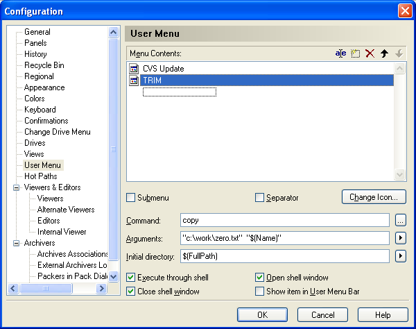

1) Copy your directory using the Copy (F5) command
2) Go to the target directory, open Find window (Alt+F7), and find all files
3) In the Find window select all found files (Ctrl+A)
4) Open User Menu (F9) and choose your prepared command TRIM.
How to prepare the TRIM command:
1) Create a zero file in your working directory (C:\Work\zero.txt)
2) Options > Configuration > User Menu
3) Insert a new command TRIM, please look at following screenshot.

Dear Jan,
Thank you very much indeed.
Děkuju!
What a quick and professional support. Amazing.
Works like a charm!
(If you find the time.... Could you explain what actually happens? So far it seems like magic. I assume that every file is overwritten with the contents of the file zero.txt. Correct? Is it normal that the file zero.txt exists in every directory after the operation is carried out?)
Best wishes
Tim

Tim wrote:There's still a file called zero.txt in every directory.
Strange.
Please try to clear Options > Configuration > User Menu > TRIM > Close shell window option.
After TRIM command will be executed, the command shell should stay on your desktop. Could you please show me the output (use copy&pase from command shell window)?
It should look like this:
D:\testdir>call copy "c:\work\zero.txt" "test2.txt"
1 file(s) copied.
D:\testdir\dir>call copy "c:\work\zero.txt" "test1.txt"
1 file(s) copied.
D:\testdir\dir>
