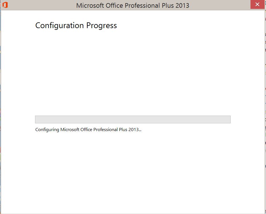

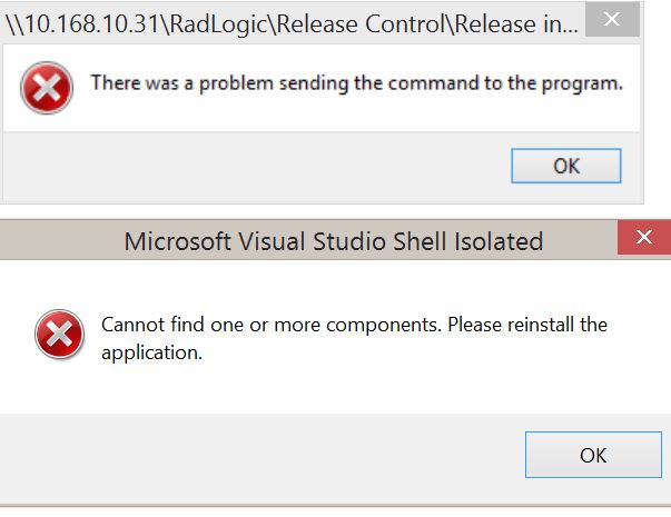

I cannot open any file directly from your window e.g. if I have a word document and if I double click on that to open in MS-Word. I get the document open in MS-Word but I also get Office Reinstall screen (see attached capture.jpg file) which I am not getting if I don't use your software. Second, example if I have a file with sql extension then this file should open in SQL Server which I have installed on my machine but I am getting a message (see attached sqlCapture.jpg file).

This is I am getting when I tried to open sql file
This is I am getting when I tried to open word document

Do you run x86 (32-bit) Salamander on a x64 OS, by any chance? Or is Salamander elevated? Or started in some compatibility mode?
Your problem sounds very specific to your installation. I think you should ask your system administrator to have a look.

I uninstalled x86 version and installed 64bit version and everything is started working like a charm!
