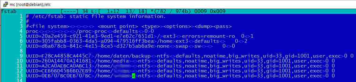

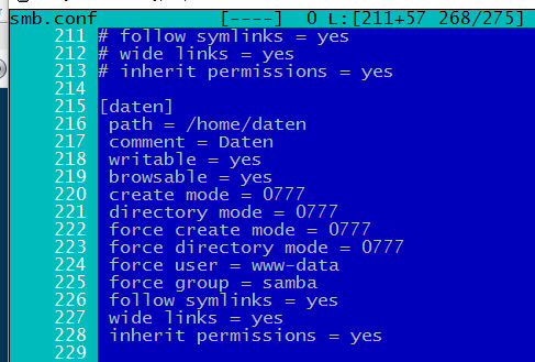

could you also post your samba configuration - smb.conf and fstab? Are you by any chance using symlinks somwhere along the path?

As you can see, the first dir to move in my pictures above is on "/home/daten/bilder" (ext3), he second is mounted as "/home/daten/backup" (ntfs).
But - I think - you are on the wrong path - since:
It's totally equal, whether I move from ext3-disc to ntfs-disc or vice versa, with or without symlinked directories or not -
I can try what I want (and I've tried a lot the last year in samba-configuration, fstab-configuration etc.!) moving a whole directory (equal with or without files in it) from one disc to another it does not do! If you stay within one disc (again: equal whether it's ext3 or ntfs) copying and moving files, whole folders and so on there isn't any problem!
Since I don't have two ext3-discs mounted, I'm sorry that can't prove moving between two ext3-discs. But I think - over samba it wold be the same prob.
And you can see: my TotalCommander solves all these probs with no complain in the same environment.

I assume the move works fine when you mount each disk as different share and move directories from one samba share to other?
In such case we know about this problem and have i on to-do list with lower priority (you are probably first Altap Salamander user how reported it).
I don't actually see the /home/daten/bilder (ext3) on the pictures but that does not matter. I think I got a picture of your setup.
You have two mounts /home/daten/bilder (ext3) and /home/daten/backup (NTFS) mounted under one samba share /home/daten. That should work just fine (I see the post from Jan now...so probably a bug then). (except the symlinks don't work at AS as we found out last time.)
On the side note: I wonder what happens to a symlink copied from ext3 to NTFS on samba using TC (I'm pretty sure it is not converted to a NTFS junction point which would be probably the best behaviour.
