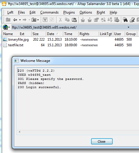

Re: 3.0 beta 1: cannot connect using FTP with Explicit SSL
I'm unable to reproduce this problem, please see attached screenshot.
Could it be some problem with your firewall or internet connection?

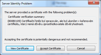

FileZilla is displaying following confirmation dialog box:

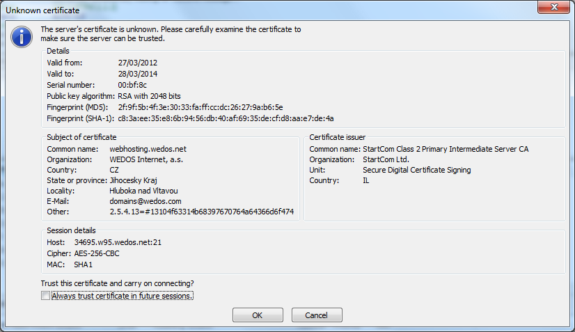

Salamander FTP plugin is using Windows API to validate certificate. When certificate doesn't pass validation, confirmation is displayed.
( Address: ftp.secureftp-test.com Login: test Password: test )
You can test SSL connection to kmlinux.fjfi.cvut.cz - you should not receive any certificate confirmation.
