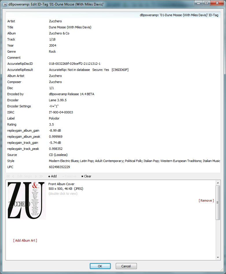

Almost everything.
Look here with a file that has v2.4 tags (only):
And here what really is in the tags:

I did some testing with text encoding in Unicode_UTF8 instead of Unicode_16 (as I did before). These are the 2 option I can select in dBPoweramp.
It still does not list all the fields with multiple entries correctly (shows only one in v2.4, and all in v1.1 !) but it now shows at least most of the fields.
So, it turns out the MMViewer does not support Unicode_16 - as seen in other parts in Salamander.
