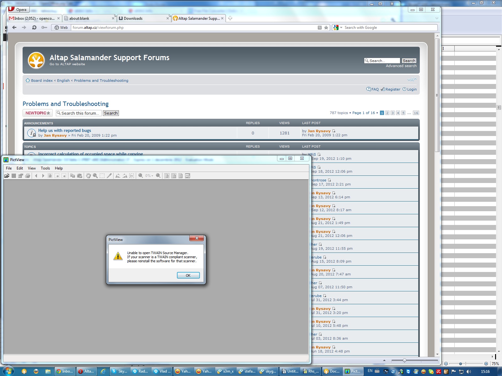

hi, i wanted to make a scan with pictview, thing that i do very often with 2.54 and it works great (only problem is i cannot scan in pdf format)
today, i tried to scan with 3.0 beta,and i get this error mesage when i try to select scanner source (attach)
P.S. i dont even get to select source...as this message appears right after clicking the "select scanner source".
I should mention that pictview in 2.54 works just fine
Hope my post will help fix the bug
If you need more information please tell.
twain source manager - Untitled.jpg (364.97 KiB) Viewed 28324 times

Are you using 32-bit or 64-bit version of Salamander?

64 bit version...havent tried on x86
Re: bug report in pictview
Could you try it? - so we can know whether it's a problem related to the 64-bit version, or to some other changes made between v2.54 and v3.0b.

well, i just tried x86 version but only on windows xp (x86) for now i dont have any w7 x86 to test it on....and it works,i could select the scanner source and i even got to scan the page....so i guess the x86 verion works....

you are right...i can always install x86 version of salamander on x64 system...so i did that and it works , the plugin works as it is supposed to do, i can select the source and then scan ...
so everything works as it should...guess the problem is in x64 version.Good luck with that.

We have added support for scanning using WIA to version 3.07 x64. TWAIN x64 seems to be much less popular, so we will not support it now.
