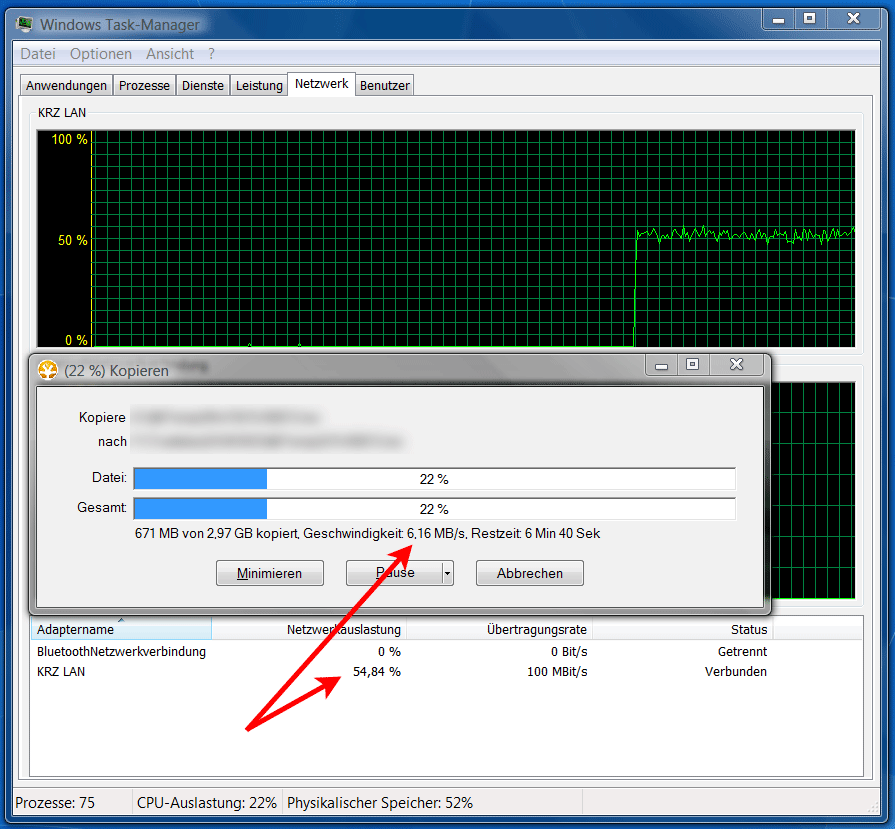

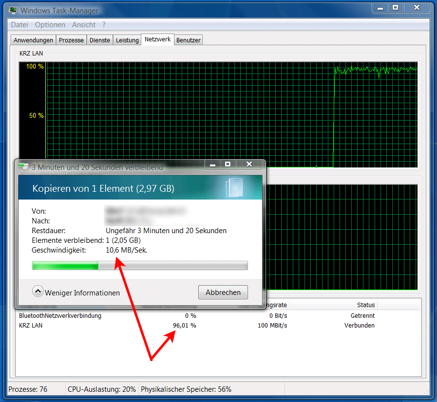

Hi there,
the copy-speed with Salamander to a mounted Network Share is half of the speed compared with Windows Explorer. I copied the same file to the same share with Salamander and Windows Explorer (please look at the pictures). Why is there such a huge difference?
Re: Network Copy-Speed Salamander vs. Windows
Yes, we know about this problem. We will switch from our current copy routine to standard Windows copy function. We will get exactly same transfer speeds as we know from Windows Explorer.

Faster asynchronous algorithm is implemented from Altap Salamander 3.0 beta 3 (PB103).
Please test it across your networks and let us know in a new thread if you find any problems. Thank you.
