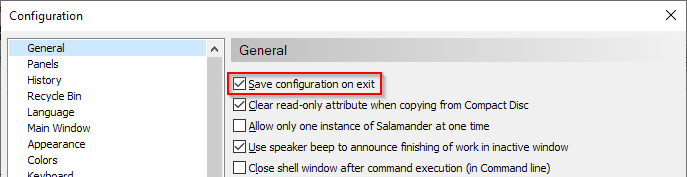

I'm now using version 4.0, although I am a paid up user from long ago. With this new version, the "Save Configuration" menu item does not work. Whatever state I left the program in is what I see when I restart the program!

Hi Bill,
this works as intended for me (checked x64 version only).
Please check the following setting:
If you want this option unticked by default, untick it in all running instances of AS, then manually save the configuration in one instance.

That worked, thanks!
