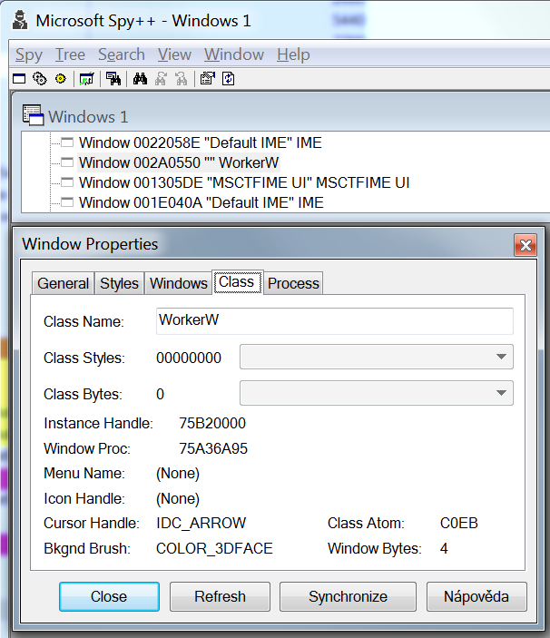

I can reproduce this problem also in Windows 10.
I wrote small test to show handle of focused window. It is really window opened from Salamander process, it has class name WorkerW. It definitely isn't our window nor our registered class name. https://www.google.com/search?q=workerw+window+class
In this case it has Instance Handle 0x75B20000 and Window Proc 0x75A36A95.
From https://msdn.microsoft.com/en-us/library/aa233565
Instance Handle: The instance handle of the module that registered the class. Instance handles are not unique.
Window Proc: The current address of the WndProc function for windows of this class. This differs from Window Proc on the General tab if the window is subclassed.
So WorkerW class was registered by shlwapi.dll and window procedure is in user32.dll.
Window Proc on the General tab is 0x769698C5, that means the window is subclassed and window proc is in shell32.dll.
Conclusion: it really is some utility window created by Windows. It is activated instead of our main window.

Jan Rysavy wrote:Conclusion: it really is some utility window created by Windows. It is activated instead of our main window.
Isnt it becuase the WorkerW thread should receive the window handle of the Salamander instance and then set the focus to it?.
I am not a VC++ coder so please bare with me. According different posts the WorkerW is a "more reliable" replacement for Progman. So what now?
Re: Global shortcut key doesn't activate Salamander
I have no idea. WorkerW window is some system window created inside Salamander process. It probably isn't documented, I didn't find API to interact with. And it looks like it is activated instead of Salamander main window. There are other system windows opened from Salamander process, for example "Default IME" with class "IME", or "MSCTFIME UI".
It seems the problem is not related to WorkerW window. Now I can reproduce this problem with Thunderbird (again) and activated window is "thunderbirdMessageWindow". Window activation process is non-trivial.
