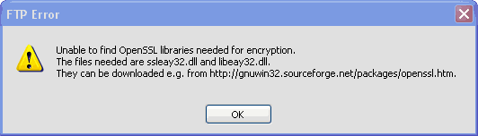

Hello,
after upgrading Salamander from version 2.54 to 3.06 I have found out that sometimes, when using FTP client plugin I am getting the following error:
After further inspection I can say, that the error dialog opens only after pushing Connect button from Connect to FTP server plugin window, when "Encrypt control connection with TLS/SSL" is checked.

What Windows version are you using? Altap Salamander 3.06 already contains OpenSSL libraries (C:\Program Files (x86)\Altap Salamander\utils\libeay32.dll and ssleay32.dll). It looks like some problem with paths.

Thaks for your reply. You are right, the libraries are in this folder. So, do you think is it possible that problem arises because I only unzipped version 2.54 (I guess there were no OpenSSL libraries) and then I upgraded to version 3.06 and no path were set in my environmet during previous installation process?

Thank you, we will fix this problem in Altap Salamander 3.07, we are finishing it right now, it should be released next week. Please let us know if it solved problem for you. Have a nice weekend!

Ivo, can you confirm if the problem is fixed in v3.07?

Hello,
the problem seems to be solved in 3.07.
Thanks
