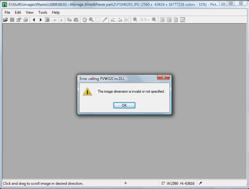

I have this problem on Vista for a few times : some pictures can't be displayed with PictView because, I guess, of a negative value of its size. My Vista is unstable at the beginning (I can't select anything with the mouse) but it stabilizes itself after -_-' So I think it was the issue but I was able to see the image I couldn't see before Vista become stable... I hope it's clear :$ (sorry for my english)..
Anyway, I don't know if this is linked to Vista. Has someone ever had the same problem ?
there is a screenshot if it can help
thank you !

No, screenshot doesn't help. Is it possible that the JPEG in question has the height of 63616 pixels? Please send us a sample file to our support email address: support (at sign) pictview.com - see the About dialog. Thanks!

The image size is correct (2.560x1.920). I never had this problem under XP so I think it comes from Vista. I was just wondering if this could come from a compatibility issue or from vista, and if someone had the same problem :?

pyonpyon wrote:I have this problem on Vista for a few times : some pictures can't be displayed with PictView because, I guess, of a negative value of its size. My Vista is unstable at the beginning (I can't select anything with the mouse) but it stabilizes itself after -_-' So I think it was the issue but I was able to see the image I couldn't see before Vista become stable... I hope it's clear :$ (sorry for my english)..
I have finally been able to reproduce this problem. Finallly. The problem was occuring only in thumbnail mode when there were some .MOV files from the digicam in the same folder.
It will be fixed in the next Altap Salamander version (2.52).
